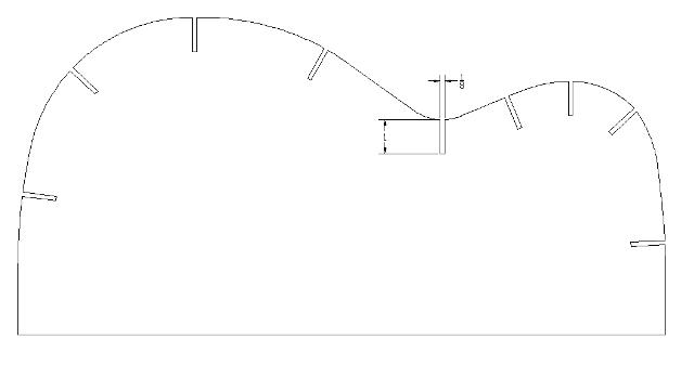

PostPosted: Thu Feb 16, 2006 2:59 pm
Yes tangent to the arcs and flush. I built my first four froms this way and aluminum flatbar is a good heat sink if you are using bulbs for heat. I slotted mine on the band saw. spaces about every 1 1/2 to 2" helps with an even heat dispersment. I think I still have a autocad drawing of the plan for my OM If you like I can post it in the morning.
by the way the manufacturing tolerance for 1 1/8 dowels is more than likly + 1/16 -1/16 so 1.09 is in the acceptable tolerance.MichaelP38764.9656828704

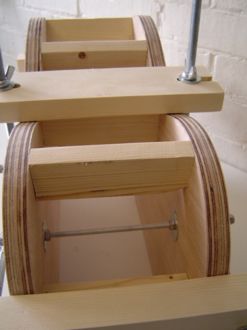

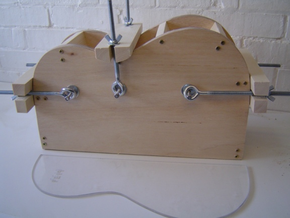

PostPosted: Thu Feb 16, 2006 9:03 pm
I just built a new side bending form at the weekend for a new body shape (a classical FE19) that I'm starting to put together. I have never used wooded dowels or metal rods for my bending forms as I use a blanket and the metal rods were originally used as heat sinks when using light bulbs. I always use flat stock instead.
Alignment is assured by drilling the connecting bolt holes together, I then install threaded inserts and the rods are screwed through and held with nylock nuts. The top slats are then just screwed in place and profiled to the required curves.
Just another way.
Heh, I just noticed when I put the picture up that I've left a screw out! A lot of people say I've got a screw loose! Colin S38765.2118402778
PostPosted: Thu Feb 16, 2006 11:20 pm
Colin, your design looks quite similar to mine ! Just a few differences. it looks great!
PostPosted: Fri Feb 17, 2006 1:59 am
Ok Scott here it is the slots are 1/8 x 1 for 1/8 x 1 aluminum flat bar
PostPosted: Fri Feb 17, 2006 5:30 am

Ahh... Now I understand. In my mind I had the slat lying perpendicular to this. Got it now. Thank Michael!
Colin - thanks. Never thought of flat stock. I don't know why everyone uses dowels when yours seems simpler.
